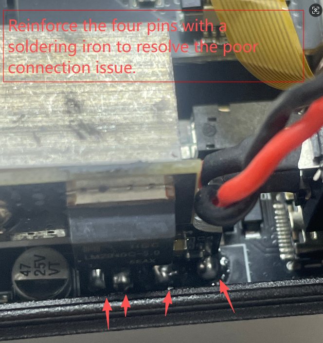

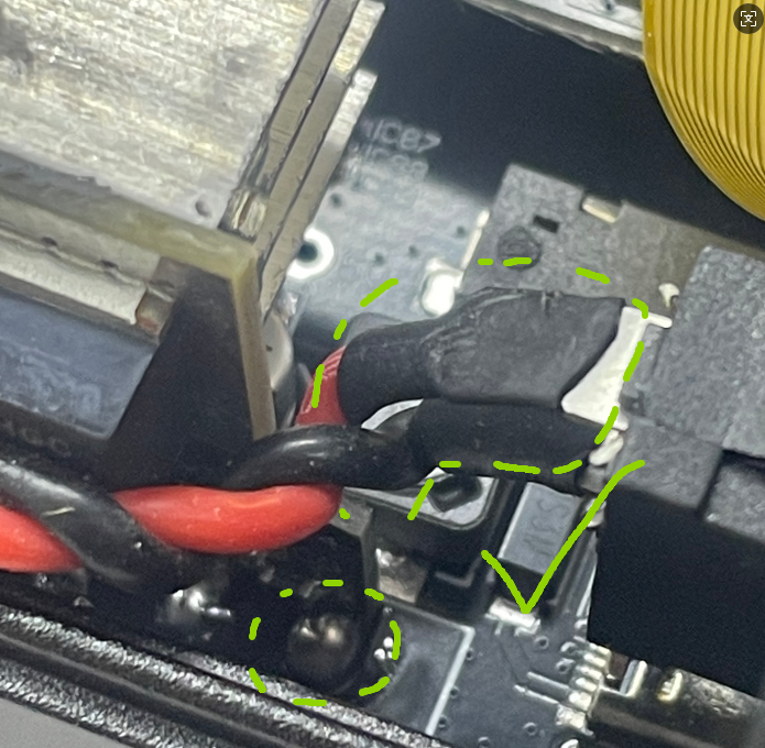

Due to compression of the package during international shipping, some device power modules malfunctioned. The repair method is as follows:
1. Open the device casing.
2. Adjust the pin orientation of the power switch to avoid interference with the power module.
3. Reinforce the four pins of the power module using a soldering iron.
4. Repair complete.
