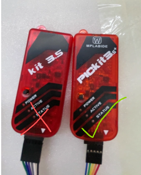

The "ki3 3.5" is of poor quality and cannot be properly burned. Please purchase a burner with the logo "PICkit3.5+".
You can try modifying the output voltage to 4.5V.

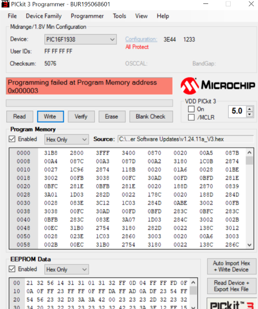

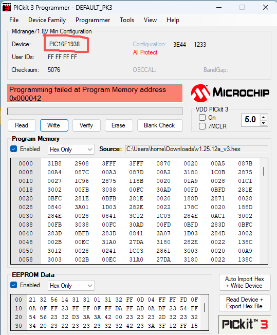

If the chip model "PIC16F1938" is recognized, it means your wiring sequence is correct; the failure was caused by a loose cable during the upgrade process. Alternatively, it could be a Windows operating system compatibility issue.
In this case, don't worry. Just ensure the cables and pin headers are connected correctly and securely, and it will succeed.You can try cleaning the interface with alcohol and then try again.
You can try modifying the output voltage to 4.5V and check box.
