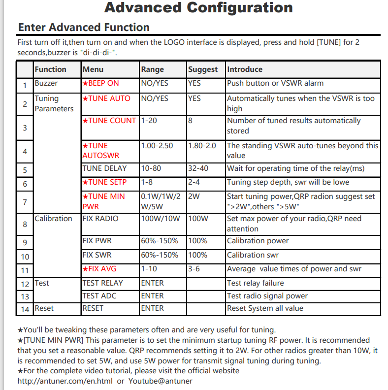

Hello dear OM, I purchased your product through aliexpress, it's coming soon. I started reading the manual. If I understand, using a tr usdx, will I have to set the power on the tuner to 10w?
A:
When you use a QRP device (for example, usdx), you do not need to set it to 10W, as that tuning power is too high for usdx.
1.ATU: Set ATU [TUNE MIN PWR] to "1W" or "0.1W"
2. usdx: Set it to 2W
3. Perform tuning
After tuning is complete, adjust the normal transmit power (e.g. 10W for QSO)
